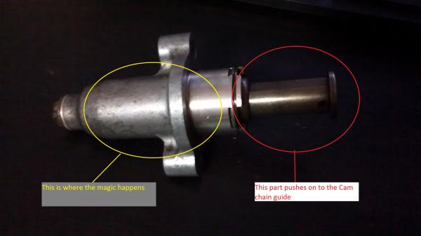

Normally 4 stroke bikes last quite long. What's your mileage. My 05 r6 has 124000km still going strong. Just done valve clearance, cam chain guides and tensioner @ 110000km.

cam chain guides and tensioner, were there signs that shows u must do? or u just decided to do after certain milage? how much did they cost u?
Signs of tensioner about to fail is the excessive noise coming from the right side of the bike at the oil pickup cover. The best is when you are doing valve clearance ask the mechanics to check the condition of the guides as well. Another way is to remove the tensioner then try to use force to push the pin in. If it compresses then your tensioner need to replace. I don't recommend you to do it yourself because you'll have to wind it back up before installing and the potential of screwing the bike is high.
Just in case you are wondering what is actually on the otherside of the tensioner, i've attached a photo of the auto cam chain tensioner from my bike. The one circled in yellow is the part where the mechanism is which only allows it to only push on the timing chain. Basically, you cant service it once the ratcheting system in there is gone(which it will definitely do), its gone. So to me its sensible to replace it together with valve clearance to have a piece of mind.
Manual tensioner is just a bolt with a locking nut at the end. Bought for $60 shipped off ebay.
