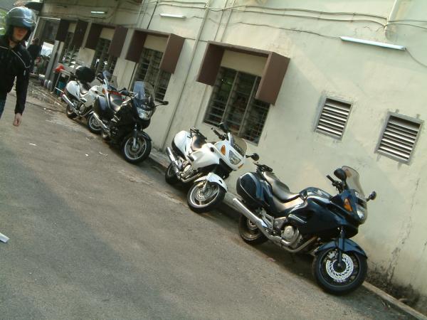

pic1: park our bike out of ah soon bah kuteh shop.

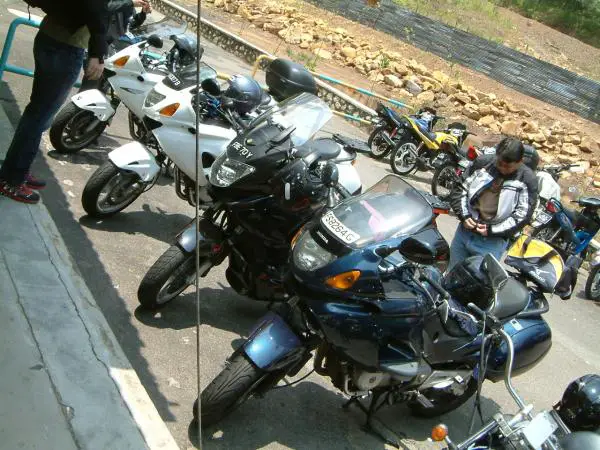

pic4: parking bike at kota tinggi car park
