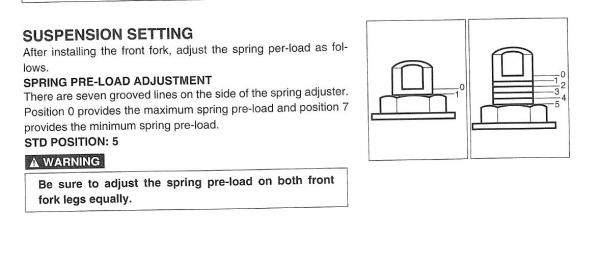

As for you issue with suspension. Most of us feels that it is too soft. You can adjust the suspension to your liking by turning the knob. Changing fork oil / spring will help the bounch further. Changing the fornt fork assembly may eliminate that fully.

adjust suspension by turning the knob? I do know the rear is adjustable but as for the front can meh?thats mean to say my fork oil need to be change after prolonged period of use cos i really feel kinda hard? my ride is bout 34K mileage liao...
right at the top of each fork there is a tapered knob. use your spanner to adjust it. there are 7 rings on it. the more rings there are the softer it is if im not wrong.. come down for the meetup this friday then we'll help you with your bike. can ask questions also. no need shy..
ah, suspension wise, u can guide them where to adjust, but u cannot tell them this setting is good this setting is bad..diff people diff style of riding, diff feelings...some might feel it 'tight', some might feel it 'loose'..hehehe...
like mine, i lowered my front suspensions.. and its at the fourth ring. some might find my setting not suitable for them... and i dont even recommand azrme to try my settings...

Dinie, if i not wrong, the more rings u can see, the harder it is..
really? thanks for pointing it out ah gui!
.....right at the top of each fork there is a tapered knob. use your spanner to adjust it. there are 7 rings on it. the more rings there are the softer it is if im not wrong.. come down for the meetup this friday then we'll help you with your bike. can ask questions also. no need shy..
taken from the manual....
