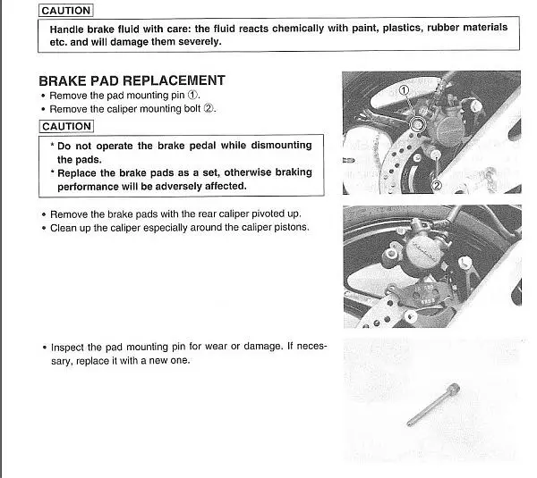

Thanks motorfreak n imran 4 de in-depth how-to. i prefer to try de easier one 1st(remove rear pads). Pics would really help alot.

Alamak bro i was caught up in a meeting last nite ah. Perhaps tonite will service my rear brakes and take pics for it. Sori again.

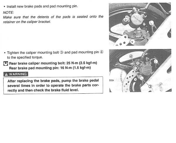

Yo WAK Dean. Found this in the most obvious place lah bro. Lucky u sent it over to my workplace the other time. Hahahaha. Attaching some screen caps for ya. U would understand easily from the pics. :thumb:
Do get back to us if u find any difficulty. No harm asking, i'm always ready to help after u going through the trouble to send the manual :thumb:
