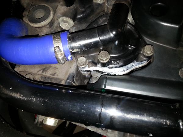

Hello, Riding spec 1 my coolant is leaking from the bottom part check it and found where it came from. The mechanic told me it the water pump leak and need to change quote about $220 to $250 and not included Radiator Flush. Anyone have this problem before? is the price ok? Thanks20140830_105850.jpg

Hello, Riding spec 1 my coolant is leaking from the bottom part check it and found where it came from. The mechanic told me it the water pump leak and need to change quote about $220 to $250 and not included Radiator Flush. Anyone have this problem before? is the price ok? Thanks[ATTACH=CONFIG]310736[/ATTACH]
Price for replacement is about there but usually $220. The other option is to see how the leak is coming from. If you open the pump and see that the housing or casing is rusted and has a hole..can always use Aradite or sound heat resistance epoxy. But if no hole on the pump chassis or cover housing..it's the pump water seal that has harden and crack. There are two rubber _O-ring seal..big and small one..big for coolant and small for eo I think..can be purchase from FJT or LAB (less than $10 a piece) but u have to DIY. Also get the rubber gasket seal for the pump cover. Good luck.
Hi,Ah Pek was thinking to PM regard to this matter and luckly you have answer my question. I guess i have to send in workshop to do it as this is my first spec 1 bike not yet dare to DIY. Thank you for your reply. Cheer Bro.
