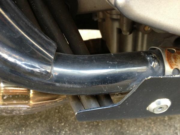

photo1.jpg hey guys, i encounter a problem. there is some coolant of fuel have been dripping from my right hand side of the 3 tubes. i have no idea why. it always occur during the afternoon. i went to shop he say either my coolant or my fuel overflow but my fuel was once full and now half. it occur 2 times already. shop say it is nothing. but kinda kan chiong about it. any advice will be much appreciated. thank you in advance

Those are overflow tubes. They are the purpose of allowing overflowed liquids to come out which is normal.
Might be condensed vapor due to the hot weather etc.....
if huge quatity of liquid coming out, it's a problem then alright.

[ATTACH=CONFIG]250555[/ATTACH] hey guys, i encounter a problem. there is some coolant of fuel have been dripping from my right hand side of the 3 tubes. i have no idea why. it always occur during the afternoon. i went to shop he say either my coolant or my fuel overflow but my fuel was once full and now half. it occur 2 times already. shop say it is nothing. but kinda kan chiong about it. any advice will be much appreciated. thank you in advance
The three rubber pipes are for:
1) Water drain hole at fuel cap area. The fuel cap itself ( about 1.5 inch diametre with rubber gasket) seals the tank itself so water cannot get in to foul up the fuel. However, there are gaps around the fuel cap assembly and key hole which allows rain water to seep through. If you open your fuel cap you will note that there is a hole for the water to drain off. One of the tubes connects to this.
2) Coolant reservoir overflow. This is self-explanatory.
3) Fuel breather pipe. This is connected to a valve under the fuel tank and it's purpose is to balance the air pressure in the fuel tank as petrol is sucked out by the fuel pump.
So, if you see some liquid flowing from the pipes it's easy to eliminate what is the source. Touch the liquid and smell it. What does it smell like? Next, check the coolant reservoir. Is the level too high?
If it smells like water and when you notice the liquid flowing was it raining earlier while your bike was parked?

Hey bro ramsnake. It usually happen after a heavy rain and while i am riding in the afternoon. I didnt check it because i was too stunned already. But i have a big feeling it is fuel because the smell of fuel was strong for the both times that i encounter. Should i be to worried about this? Never encounter this situation for the past 3 yrs riding my revo and it happen 2 times within 2 weeks.
