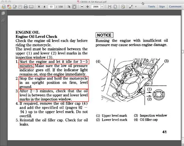

guys, can i ask how to check on engine oil level?
i notice a round sight-glass on the side of my spec 1. do i leave the bike on side stand or need the bike to be upright before reading the level?
Leave on side stand will do. Its just a rough indicator to shows ur engine oil level.
the correct method would be to keep it upright before checking (you can ask someone to sit on your bike and keep it up if you dun have a center stand). however you dun have to check your engine oil if you change the oil regularly every 5k km unless u suspect your engine oil is leaking. if you check it while on side stand u might not be able to see any engine oil in the sight glass at all.

Thanks for the prompt reply.
So if the bike is uprght, the correct level i assume would be half of the sight-glass?
For my case the indicator is always fully covered with engine oil. Think there's line that shows the min level.
the correct level is anywhere between the min and max level marking which is visible beside the sight glass when upright. it doesn't have to be exactly half, like r1der mentioned it is just a gauge to see if u have enough or too little or too much engine oil. another thing to take note is that you only check while ur engine is cold or parked at least for awhile after riding. if you check the level after riding or starting up the bike, the oil level will usually be lower.
Nope. Sorry, but there's nothing rough about the indicator and leaving the bike on the side stand will give you the wrong reading.
Changing oil every 5,000km, which I don't recommend, doesn't mean that you don't have to check the oil level.
Yes that's true. For me i normally check with side stand and can see the engine oil clearly. It makes no difference to me with side stand or up position. I can always see the oil level.
If you can see the oil in the sight glass when the bike is on the side stand, there is too much oil in your engine.
Check oil level when engine is warm, i.e. 2-3 minutes after idling for 3-5 minutes.
Refer page 41 of User Manual.

Here it is.
(Note for SBF: @Andy
Normal image uploader is not working. Basic uploader is ok.)
Be wary of the source of information for your bike's maintenance. Some FAQs are compiled by people who lack the technical know how. :angel:
Here it is.
[ATTACH=CONFIG]273959[/ATTACH]
Woo thanks bro. Good share. Nothing beats a manual :)
