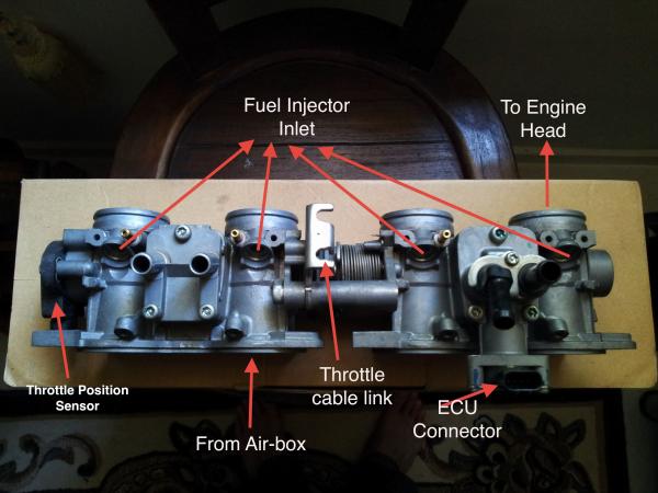

After verifying with planet motors where i did a temp repair there, actually the throttle body sensor and throttle positioning sensors are two different components. Apparently the tps is easy to get, now I worry for where I can find the tbs, i have to replace it or i will face the same problem in the future..ramsnake, winner or anyone can help? Thanks...
Sorry, but I've only heard of TPS. Probably I'm ignorant of TBS. Anyway, when you finally managed to get it replaced, maybe you can post a photo here for reference. Thanks.
