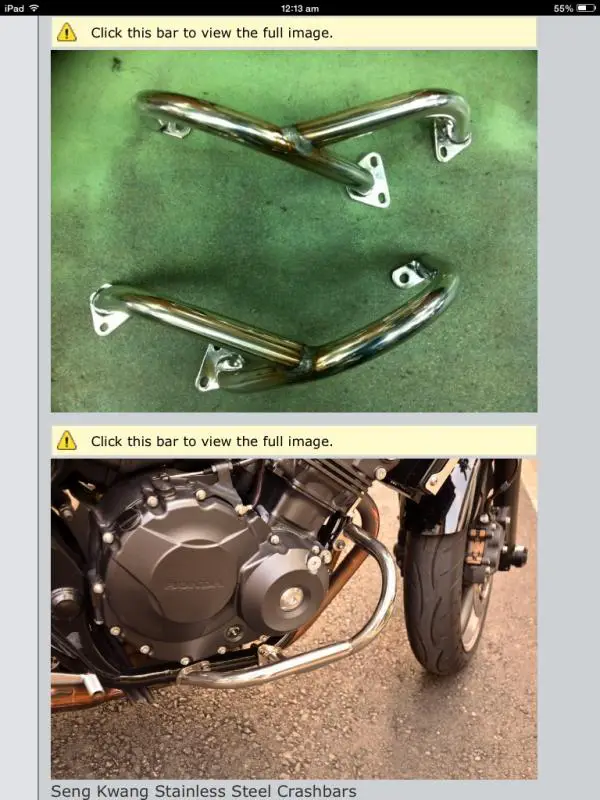

Hi Ah Pek, thank you so much for your reply. If using engine mounting point is wrong then where is the correct point to be mount?
Look at the lower main frame chassis bar sloping downwards where the base frame cradle bars meet. You see that there are two size 14 bolts there..that's where it should be used for a two point down to the base cradle using clamps support. You can use three points too but have to customize as long as u use the two points I mentioned and non of the engine mount which creates tinkling vibrations and can damage internal components when the bike falls heavily.

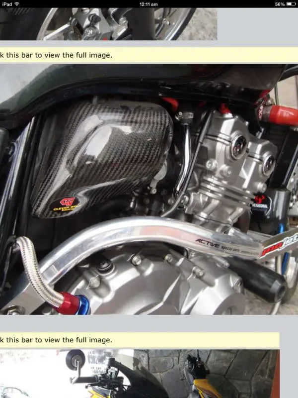

Thank you very much for your reply Ah Pek. It hard to visualized what you are say, thus I attached 2 pictures, so are crash bar installed at the correct place?
[ATTACH=CONFIG]289276[/ATTACH][ATTACH=CONFIG]289276[/ATTACH]
[ATTACH=CONFIG]289277[/ATTACH]
Yes..the one done by Seng Kwan is correct and its what I have but my is two point..meaning..the base has only one clamping. It's not cheap but SOLID.

Where did you buy the carbon fibre cover?
