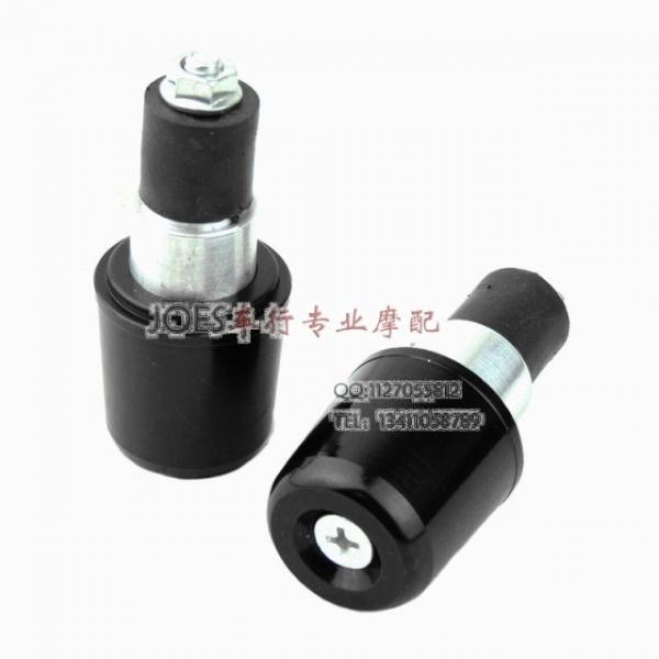

Hi new Revo user here.
Few question to ask
Any idea how much is the handlebar balancer?
I have change my handler bar back to original (Previou owner modify to other type I don't like)
Is this thing just plug in working oledi? no need any screw? cause my handlebar now is a big hole both side without anything in.
[ATTACH=CONFIG]296518[/ATTACH]
How we monitor our engine temperature ? my bike have frame install. worry it will over heat
How frequence we need to do valve cleaning[/quote
The Genuine Honda balancer weight assembly will cost about $80 each side. You can get non-Honda for as little as $15 for both! though these are just bar end plugs and not really a balancer weight.
No need to worry about overheating, the Honda cooling fan will come on if things are getting too hot. Normal engine temperature is 80C.
No need also to worry about valve cleaning, these engines are more like a car engine i.e. 4 stroke not 2 stroke. The valve clearances need checking every 24,000km, this is not an easy job and will cost $$$
Edited by Skuzz
