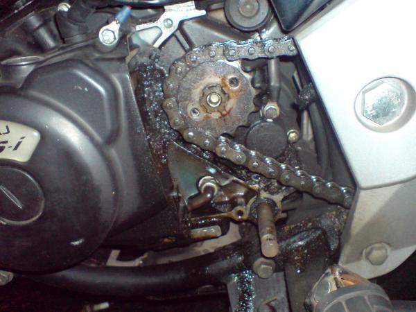

Have a look how dirty my front sprocket area. When I had changed my sprockets and chain at Ah Boy, I asked them if they can clean it. They said need to use petrol to clean it :faint:
BTW, why should speedaddict remove the front sprocket cover, Is there a chance of leak from there?
Wooh, I never saw this part before.. is it easy to access ? How do I uncover it ?

It is easy to access, it the black color metal cover just above the Gear changing lever. The cover also has the picture on it that shows how to change the gears 1 down and 4 up.There are 2 bolts, quite small, may be you need a wrench of the right size to remove it.
The mech at Ah boy removed the gear lever first and then the cover. Not sure if removing the gear lever is necessary.

[ATTACH=CONFIG]198200[/ATTACH]
wow so much rubbish inside. :faint:
there's 2 o-ring near the spocket. i couldn't be 100% sure, but ur's look like it might be from there. just clean it up, perhaps leave it overnite. if there's a leak, leaving that part open, u'll see a bleed of oil dropping instead of accumulating inside the cover.
for cleaning, various methods, soap n toothbrush does a good job, oren's method always wd40, um's method always petrol, so up to ur preference. also after cleaning, dont lube back ur chain 1st, determine where the leak is from, confirmed, then lube back n head to um. the reason if u lube ur chain, it might be the chain's oil instead of the leak.

@ revhappy .... reasons why I liked to wash my bike myself as I can clean all that area during my bike wash .... using covered or opened chain guard, that area will not free from all the oil + water + dirt that flung in there. The longer one takes to clean that area, the more messy it will be .... cheers!
@ O'Ren .. just remove the cover but before that make a mark on your gear shift pedal position so that later when you fix back the gear pedal it's at the same position.
also the longer u spent on cleaning, the more places u can think of to clean.
however at the end of the day, when ur bike is squeaky clean, u get the satisfaction, but tired.
And normally if I at UM for my servicing, I just asked them to remove the cover and I cleaned that area with a rag or newspaper myself cos the $6 servicing does not covered that part ... kekeke
next time help urself to their petrol wash at the back, after wash down with water n blow dry with air gun. after that sit back, relax with a bottle of mineral water from their fridge. :cool:
