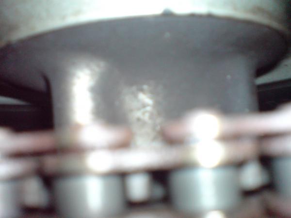

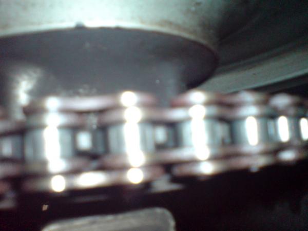

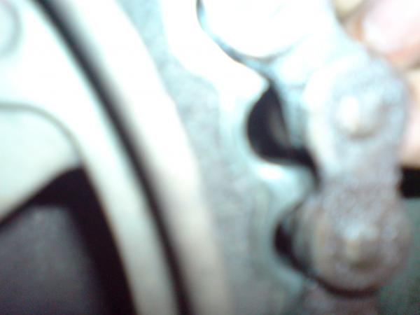

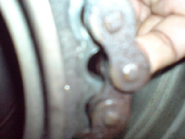

Hey guys,
When do you know that it is time to change your chain? My phantom, when I bought, the chain was really dry and some links were really hard and rusty. Then I have oil it and have tightened the chain. Right now the chain seems to be ok but if I hold 2 links and try to move them horizontally then there is some movement. The chain along the rear sprocket doesn't seem to fit tight. I can actually press it and it moves a bit inside-outside so the links seem to have stretched a bit.
I am not sure if I have explained properly. But these are the symptoms. Mainly the links have stretched significantly.I do hear some noise while riding, but its not excessive. So should I change the chain and sprocket or just live with it?
hope this info helps ....
"To test for this kind of elongation, attempt to pull the chain away from the rear sprocket at the back center. If the chain can be lifted to the height of the top of the sprocket teeth on any brand/model, then it is elongated enough to need replacement as soon as feasible and is causing undue wear. For most street-oriented motorcycles, replacement limit is around 1.5mm of play when measured like this (i.e. - being able to pull the chain 1.5mm off the rear center of the rear sprocket)." ....

"FAILURE ANALYSIS:
The picture above is an example of a chain that is failing at 7800 miles, although it has not reached it's elongation limit by a far shot. Specifically, the chain has the following problems:
The red color close to the seals on the exterior side-plates is the sealed bearing lubricant normally used to lubricate the rollers. The seals are leaking, so the lubricant leaks out and dries into a red powder (red coloring is common to most chain brands, but not all; it's the clay carrier that is part of the lubricant package);
If you look closely at the seals themselves, you'll notice what appears to be lengthwise grooves in them; this is caused by using too hard a bristle during cleaning, one in which the material of the bristles was harder than the materials in the seals;
The inner side-plates are not aligned evenly, meaning that the lowest link in this picture is already compromised beyond the point of failure;
The rider said he diligently cleaned & lubed his chain every 400 to 600 miles. Based on what I see, he should have cleaned less and lubed more.
WHAT TO DO:
Replace this chain immediately! Failed seals cause chains to bind and break, putting the rider at risk. ...... " (source: understand motorcycle chain)

Thanks bro. I will replace the chain and sprockets immediately.

Here is my chain. Looks pretty badly elongated. hehe.
