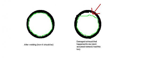

bro, may i know which part of the exhaust you're refering to? have a pic to show. thanks
sorie ah bro, slip of my mind to actually take picture of the exhaust. but its the part that connects with the engine lah. (sorie if this is not the exact term to it.)
u need to remove the whole exhaust,then look into the hole. maybe i post a drawing of how the damage looked like. I did look into the exhaust of some of those who cam for the DIY, but none had the damage.
how to insert picture ah? must use host isit?
k k,now i scrolled back saw bro roadrunner tutorial on inserting picture den noe how liao.
haha
so yah,hope this helps lah..
by right,the green lining in the picture i drew is unseen when looked into the pipe, but just to show lah hor.
should check mind if i happen to repray my exhaust next time round.

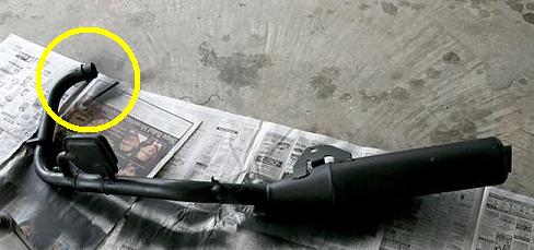

By the way,I did the welding of the head of the exhaust pipe. DEFINITELY better torque and less noisy. didnt actually think of the repercussions of not welding it, but after reading what tony said, can heave a sigh of relief
The inner exhaust or the outer exhaust?Do you mean the inner metal meshing with alot of holes?
