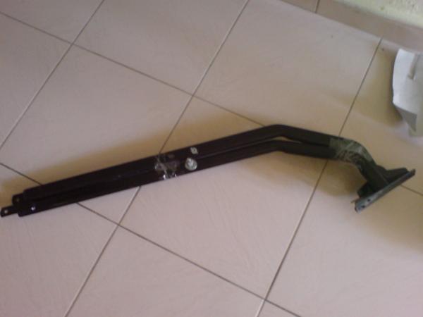

Hi Guys,
Will a super 4 bracket/rack to fix the rear box, fit for pulsar? I am getting a super 4 bracket in the garage sales section for 10$, was thinking I use it for my pulsar, but not sure if it will fit. Please advise:confused:
i dun think it will fit cos the position of the holes are diff unless u mod it.
givi brackets?
might be able to fit depending on the model
cos um oso using givi brackets
Thanks Gaban,
It just cost 10$ so I thought of taking a chance and bought it. The seller told me it was fitted to Super 4 spec 3
Here is the pic attached.
Let me know if you think this can be modified to fit a pulsar.
Edited by revhappy
