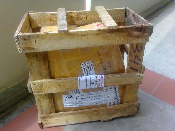

Shipments fully secured and arrived safely at my door step!!!!!! :thumb:
However I have not open it to check since I did stated earliear once the shipment arrived I will post here. :cheeky:
Msg me to collect ... I'm on MC, tonite I'll be at home. Anyone coming to collect let me know. :cheers:

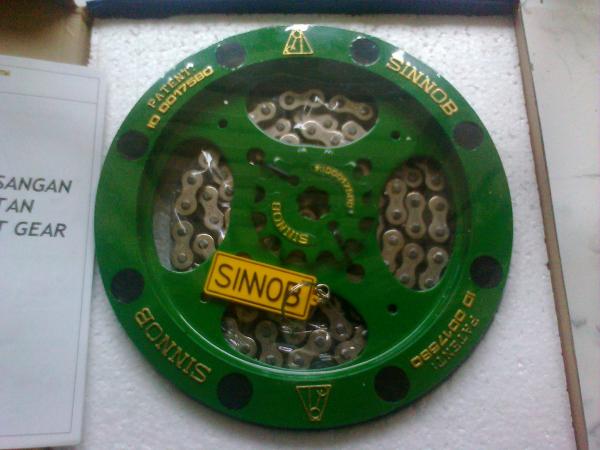

And btw .. the Sinnob Green Sprockets are for Tiger bike ... 1 rider from Tampines ordered from me last week. :thumb:
Currently I have engaged Sinnob to make a set for Yamaha YBR 125 (90% done) and CB400 S4 in the process. :thumb:
I need a favour from S4 rider here to enlighten me on the model and version spec for the sprocs to be available. There lots of version when I google for it. Which model is popular in Singapore and whats sproc size, no of holes, year of manufacture and chain size and numbers. ...
Hope S4 rider can assist me .. thanks. :thumb:
