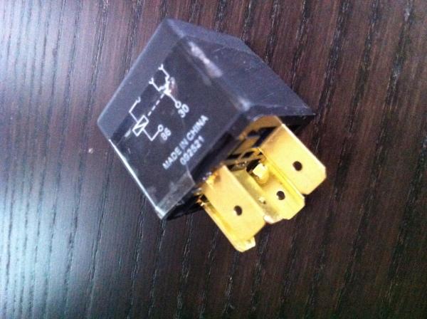

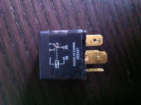

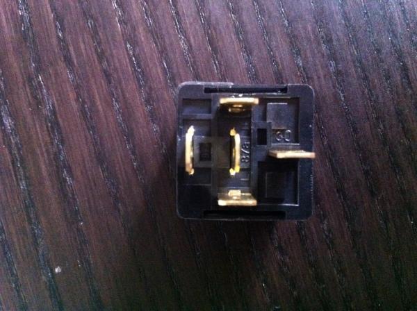

The relay's diagram on the relay is as this one here :
http://www.breyn.com/vn750/bikepics/tech/airhorns/NEWHORN.GIF
Here's photos I took, the relay schematic actually is disappearing when you handle the relay because the ink is crap, so I taped it so it's not deleted. The top left pin on the schematic is 85, to top right one, completely on the right, is the 87A.
I tested the voltage between lic plate wire and NEG of the battery : I get 12 V exactly same reading as between the battery terminals.
I think I understand what bothers you: there is no wire going to ground, is that it ? On all the relay diagrams I looked at there is one, butnot this one. But I though going back to the battery negative was enough ?
The neg of the battery is grounded, so it acts like a ground. So basically the diagram you posted in the link is the same as mine above. Only difference is that I have a distribution block after 5 and after 2, but it still follows the same circuit logic:
http://www.r1200gs.info/howto/images/Schematic.gif
http://www.r1200gs.info/howto/images/Schematic4.gif
1 is my 86 (lic plate wire)
2 is my 85 (ground)
3 is my 30 (battery +)
5 is my 87 (to accessory)

since u got two 5, can u test out the other pin to accessory, i believe it's 87A?
1)what i can suggest, take out the whole thing, just connect 86 n 85 to the term of ur battery, i believe pos or neg not important, use ur multimeter test out 30 and 87/87A. this will confirm if the relay is spoilt if there's no connection.
2)if above succeed, take the 86 n 85 from lic plate to neg of battery, test out the same point again, if succed, all's well
from your diagram, i couldn't make out if there's any indication of which leg is what pin.
the concern why i think the lic plate might not work is because of the AC current.
