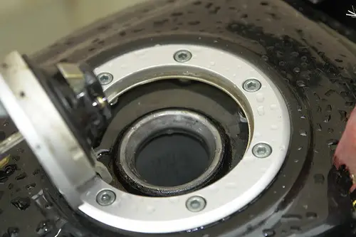

There are screws along the rim of the fuel tank lid, can you try opening all the screws that may help? After opening try playing around with the key and opening the internals.
I had a similar issue with the pulsar that I used to ride in India, but the mech told me they have to change the entire lid no other choice. Comparing UM prices with India, I guess it will cost you atleast 30$
EDIT: Oops just noticed that you have already tried opening the screws. In that case, UM is your only hope.
