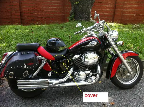

Hi,
Wonder how much to chrome the side covers? Or any bro who dun like chrome and can swop with mine?
