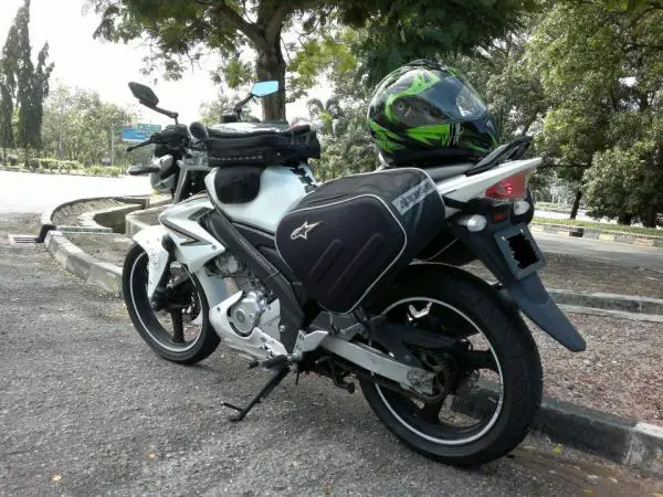

  pyro13 said:
http://img.tapatalk.com/cb74fbe8-0014-fcc9.jpg
niceeeeeeee, might i ask where did you get the under belly cover and those red tapes on your wheels?
Wer else but jb! The belly pan, rear hugger and 2 side plastics at jb costs abt rm135. Did it abt a month back.
Anw, this buke is most of the time ridden by my gf, so dun get aurprised if you see a gerl riding it hor.
