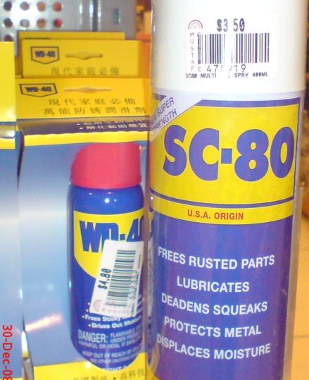

Try this product, VOLTRONIC M50 (same can bottle in this link but the colour is brownish orange). It has a small sprout out spray nozzle and a cap on it to prevent you from accidentally pressing on it.
http://www.voltronic-germany.com/Adhesive-Lube-M50.htm
No worry for the fling, try WD40 or SC80 (Cheaper) and spray a bit on the rim, use a cloth to wipe it, super easy, fast and kilat brosss.
I got this product from Foo Soon Heng Motor Repair (Autopoint AMK)

WD40 as chain lube?...Better avoid bro..from my experience wd40 causes rubber seal to swell. If your using o ring or x ring,get a purposed chainlube.
