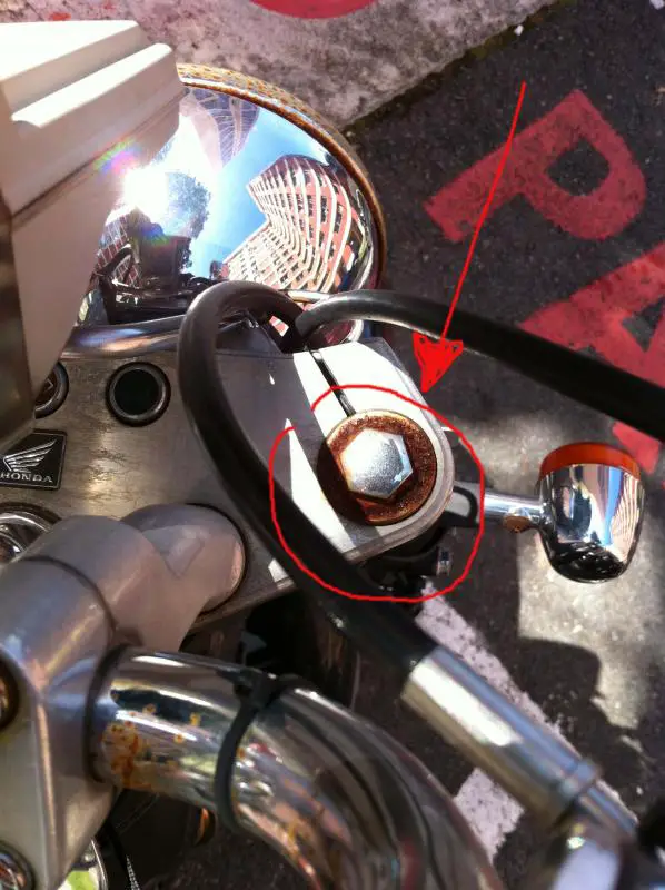

Hi guys I love my bike lots its cheap and reliable! and i wish to renew my coe when it ends next year.. however due to neglect there is rust everywhere and im gonna pay it back for the years of service my warhorse had given me.
first to start off im going to clear the rust here(attached pic) however i got no idea how to do it? any reccomendations?

nice! very loving owner! u can try get a flat file/anyting long n flat, then wrap it wif sum sandpaper and jux rub it. use increasingly finer sandpaper, n finally polish it off. nt sure whether will work. have d same rust issue as well. but nv bothered wif it. *paiseh*
:thumb:
sandpaper will do fine, i did it for my ex phantom also. get varying grit amount so you won't tarnish the metal underneath.
start with the roughest and move on to the smoother ones last.
[ATTACH=CONFIG]243405[/ATTACH]
If its too much work can send it to rudy aesthetics ;)
I'd use a toothbrush and meguairs mag and alu polish.

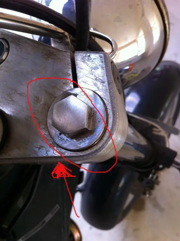

Oooo where is this rudy aesthetics? i need to remove alotttt of rust and nuts n screwss. hmm i actually went and put in 2 hrs of sanding and this is what i got. there is some rust left, it went deep i think i'll have to continue another day.. sprayed wd40 to prevent further rust

after you removed the rust, better sticker it to prevent futher rust in future or apply some chemical on it yeah!! :)
Somehow every part ( screws , bot N nuts ) are not stainless steel.. so need to clean and oil Our bike once in a while :]

good job, you removed alot of the surface rust.
