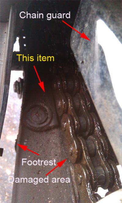

I am trying to get that piece of flat rubber which serves as a protection against the chain grinding the swingram when there is excessive slack. I don't know how it is called. It is located after the front sprocket and is apparently secured with 2 screws. Mine has worn out quite badly allowing the chain to gouge a small hole on the swingram. Can anyone tell me where I can buy it and how much it costs? If not availble, then I'll need to improvise. Your help will be very much appreciated.
Anyone has any tip to offer please?

Can take picture and point at what u r refering to? For the roller I know can buy from ever success but dunno if ur refering to the chain slider.
If yr refering to the plastic under the chain I dun recommend u improvise bcos whatever u add might get caught in the chain and cause u danger. Just bring to reputable mechanic cos I think the slider is pretty much standard part.

It may be called the chain slider as you suggest. A photo of the item in situ is as shown below:

Some damage has already taken place on the frame. Any idea of the cost and where to buy the item? I prefer to DIY myself. I'll clean up the area, patch the hole up with putty, and repaint over the patched area before replacing the slider.
The previous owner of the bike apparently had neglected its well being.
to be honest i cant see where the damage is.. paiseh arh.

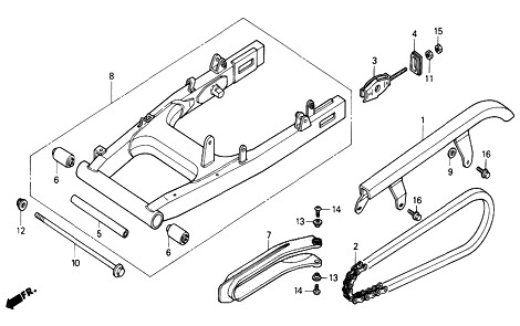

anyway it looks like its part # 7 in this diagram:
try asking for the part at eversuccess or fjt. not sure about the course but since the roller is already quite cheap i.e. a few dollars i dun think the slider would be that over expensive anyway.

The damaged area is under the chain. The arrow is pointing a little too high. If you will look closely, there is a visible narrow groove below the arrowhead that appears a little brighter than the surrounding areas. Towards the bottom of the groove is a hole which is not shown in the photo. I bought over this bike only a month ago. It has a number of shortfalls or defects requiring rectifications. I'll do it one at a time. Tomorrow, I am going to FJT to get the slider or whatever else it may be called. I also have the same parts diagram that you included here. Have exhausted all means to get the corresponding parts list but to no avail. Anyone has any luck?

for the parts diagram the only one i've found is in thai. might not be a major issue anyway cos parts are pretty standard and some shops carry parts from honda but made in china.

TT plastic item can get at planet motors for less than $15 Its called the chain slider.

I bought my chain slider from FJT this afternoon. The cost is $8 a piece. They call it 'tong chiew ni', or rubber stopper in Hokkien. I also bought the rear brake pads for $15. Not sure if this price is good. I also asked Ah Chong to test my bike for any noticeable defects. He said other than the noisy chain, everything else is ok. Big sigh of relief.
