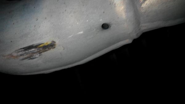

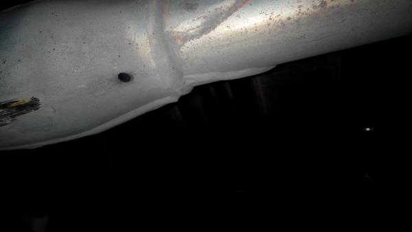

Hi Guys I am facing a slight problem. From the picture above, my exhaust manifold was scraped by a road hump while riding with a pillion. So when I checked the manifold saw that there is a scrape (which is fine for me) and another thing is the hole from the pic is it supposed to be there or it is due to the hump hitting the manifold?
Lastly after hitting the hump, there is a very soft tick tick sound from the header area not sure exactly where. ( Maybe I am just paranoid though after hitting the hump)
Hope you guys can help. Thanks!
The hump must be huge, the hole is all the while there, as for the tap, I do not know, maybe all the while there. Or it can be cam chain or valves.
am i seeing things or is something missing from yr exhaust? take full shot photo lehhh..
anyway cylinder always got ticking sound one but it depends on how it ticks. cam chain/valve noise is always there. if u scared go see mech - asking here will leave us clueless also unless u show us in person lol. and yes of course if u not enough EO or eo need to change alrd such noises are louder.
