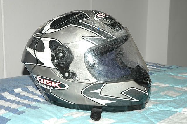

Anyways, forgot to show you guys something.
When I went too hot at one of the turns at PG, this is what happened to my helmet when I fell, hit and scraped the gravel on the side of the track:
http://i15.photobucket.com/albums/a383/redbeacon/th_020.jpg http://i15.photobucket.com/albums/a383/redbeacon/th_018.jpg http://i15.photobucket.com/albums/a383/redbeacon/th_003.jpg http://i15.photobucket.com/albums/a383/redbeacon/th_017.jpg
(click images to enlarge them)
See, despite the high price tag that it brings, fullface helmets do really work to protect your head doesn't it?
