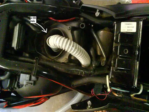

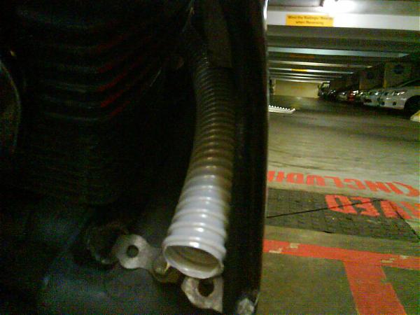

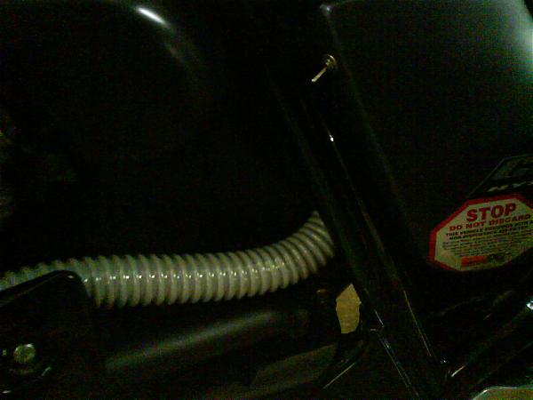

some pic of what i have done..

Btw ahsong, from the way your route the tube, wouldn't the air heat up on its way to the airbox?
The tube is just beside the engine block, not an optimal placement in my opinion.
Try to place the air intake tube such a way that it is as far away from heat source as possible.
Another way is to wrap the tube with heat shielding material. It will make any improvement even more obvious.
Please share with us how your ride feels after what you have done.:thumb: :thumb:
