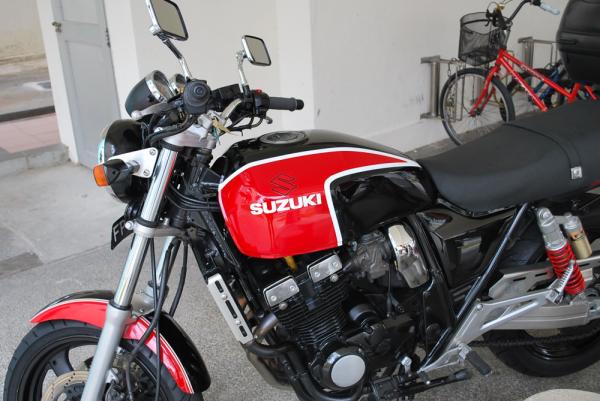

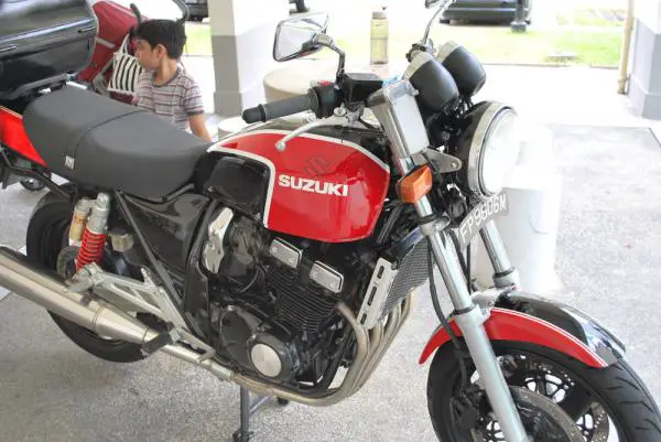

All in all, I paid $45 for the chain guard, inclusive of shipping from UK ($25) to Singapore, and it should arrived by next week.
http://i184.photobucket.com/albums/x97/S750WP/7-2.jpg?t=1268278084
http://i184.photobucket.com/albums/x97/S750WP/6-2.jpg?t=1268278108
http://i184.photobucket.com/albums/x97/S750WP/5-1.jpg?t=1268278127
Edited by S750WP

Thinking to respray my bike to this retro design paintwork.
Edited by S750WP
