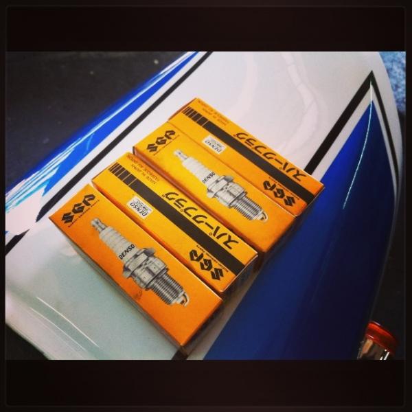

I took a pic of the Sparkplugs-
No starting issue so far. I've not try riding for a long time yet, it's about 20 minutes to my office and the heat is OK.
According to the mechanic, the plugs he removed was #9. He mentioned that it should be avoided as they give a lot of heat.
I'll try to check the recommend plugs for Impulse, maybe I'll get a set & see what's the difference.

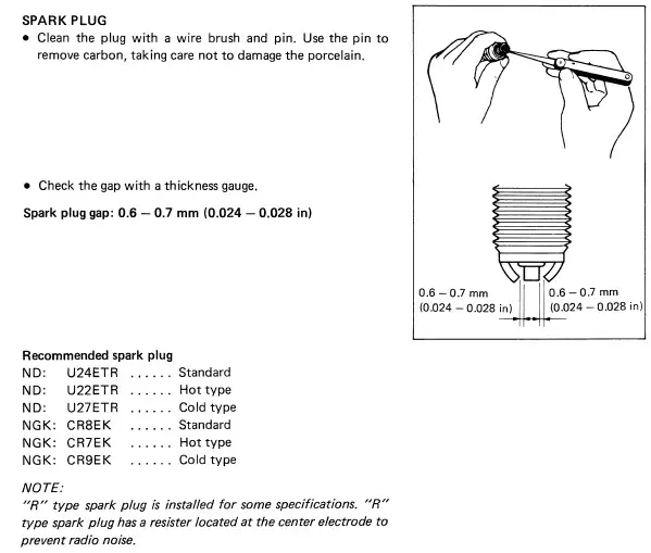

Hmm: would be interesting to see wht the manual says we should use. Do keep us updated!
I got a softcopy of a manual for a GSX400F. It could be compatible.
Attach is what is shows for Spark plug specs.

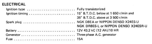

From the Bandit manual.

I think the Bandit would be a closer match to the Impulse.

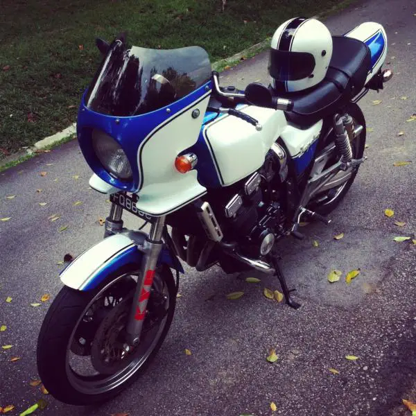

I had been under my block polishing and doing my own usual weekly 'servicing' of my Impulse, when I noticed a bike pull up nearby and stop at the kerb side. Same low rumble of the engine, stainless steel 4-1 exhaust and that lovely ducktail. I straight away went up to him and tada! Another Impulse was sitting in my carpark :D What are the odds?! His name is Michael and he say he knows the 2nd owner of my 868. So Byte, does that make you the 1st?
Anyways, here's a picture of my 868 just for the fun of it :)
