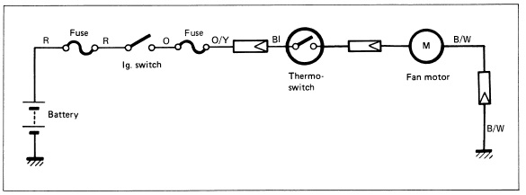

I am still trying to troubleshoot my radiator fan issue.
According to the schematic I got below, there are 2 fuse; 1 before the ignition & the other after the ignition.
The left fuse should be OK since my ignition operates fine. So I think there are 3 possibility:
1) the fuse after the ignition is kaput
2) the thermo switch is kaput
3) everything is working fine but the temperature is not high enough to trigger the fan to run
Easiest way would be to check the fuse. Anyone knows where is the fuse box?
If the fuse is still OK, then maybe I will 'jump' around the thermo switch.
Thanks.
Thanks.
I think the fuse box is behind the side small panel, can't remember if its left or right side.
For point 3, you can start and warm the bike for 10-15mins (mine also took very long), the fan should turn on if the thermo switch is working fine.
If your thermal switch is not working you can tap a switch in parallel with the thermo switch, which is how I do the fan switch mod, for manual control to turn on the fan.
