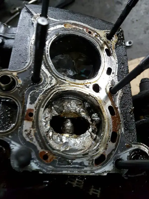

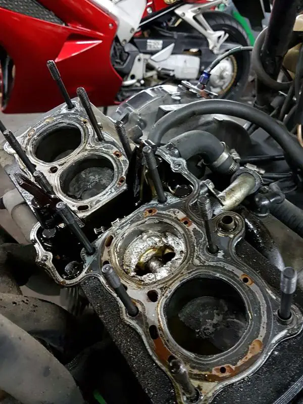

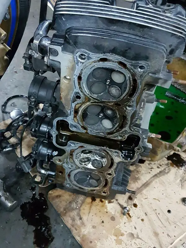

My super 4 bike spec 2 when ws riding suddenly engine power started to be slow and today its stopped. i tow it to shop the guy told engine failed. it would cost a lot to do the engine. can anyone help me to recommend me any shop in singapore that dont cost too high. IMG-20170224-WA0018.jpgIMG-20170224-WA0019.jpgIMG-20170224-WA0022 (1).jpgIMG-20170224-WA0022 (1).jpg

from ur pictures..a guess is that u never change ur coolant until it become so brown n also maybe never clean or flush ur radiator and got clogged and never cool down ur top block properly until the piston over heat n melted.....you can ask ah chong from plane for an honest quote perhaps.....you may need to change to a new or second hand top block if cannot rebore to fit new bigger sized pistons......new pistons and piston rings set....at least two sets of intake valve and exhaust valve...a connecting rod assembly to ur piston as it looks melted....,,,,..a lot of work and at least 2k maybe?
