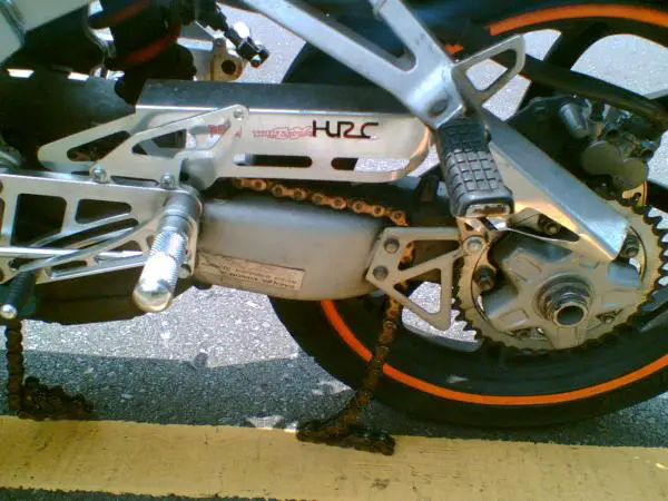

my incident due to sharp sprockets
woah..ur chain guard dent?at first look i tot it was a new model..lol den closer look was its dented out..hmmm my spocket not dat sharp yet..=x

the chainguard was lousy one.. too thin already. i have change to a thicker one. damn good quality.
