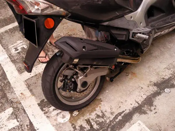

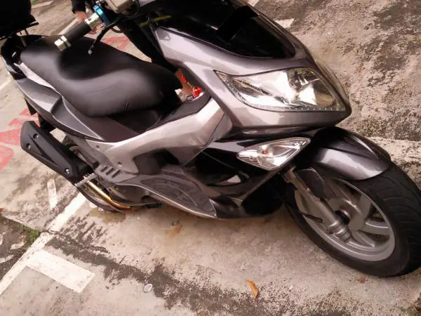

Pics of my bike. Pls share yours too.
Bro, did u open up ur headlights to fix in the leds there?
