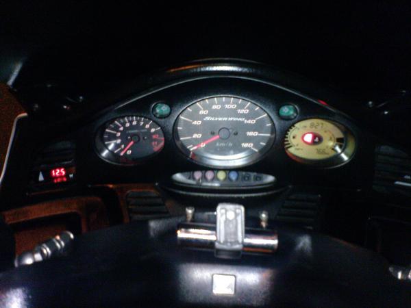

Mine voltmeter suddenly reading 12.5V constant.. :sian:
Is a voltmeter a must-have for bikes? I'm really a noob in this...what kind of readings would show that our bike is running normally? 12.5V is too low? Which shop is recommended to fix a voltmeter? Any advice really welcomed! :thumb:
for scooters, Yes. cos scooters, when battery dead, dun have a kick starter & being automatic, unable to push start. so its good to have a voltmeter to monitor the bike's battery.
At which shop do u guys fix yr voltmeter? Any recommended models? Thinking of fixing but have to fix at a place where it won't be easily stolen right?
refer to the picture below, i tink thats the best place to install liao :)
2 roads diverged into a wood, and I-I took the road less traveled and that makes all the difference!
Where did u fix up the voltmeter? Cost? Have to cut away 1 of the plastic panels?
fix up under my blk..haha
meter bought from the mass order, brand dynamax i tink..
