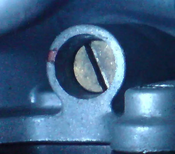

the air screw is it turn clockwise to close it completely? So turning 1.75 rounds out means turning anti-clockwise rite?
yes / yes
suggest use a perm marker to make a mark at full close position for easy reference

yes / yes
any differences?? if tweak the air screw?
Arai V-Cross2 Arai Rx7r3 Haga Arai Ram2 Arai Rx7r3 Conlin Edward Arai Rx7r3 Mick Doohan Arai Ram 2 Arai Rx7r4 Gunmetal Arai RX7r4 Shinaya Nakano Shoei X11 Kato Black Arai Ram 3 Gunmetal Arai Ram 3 Shoei Neotec Shoei J-cruise
KTM 200EXC Gilera Runner SP Aprilia RS250 Hornet 250 Gilera Runner Vxr Yamaha Yzf 05R6 Honda Wave 125 X9 Evo 200 SilverWing 400 Yamaha Tmax XP500 NC700XD STX C650GT
it helps as a reference when turning the screw... you don't have to fully close it again before turning out to change setting from 2.0 to 1.75 or from 1.75 to 1.9, etc.
e.g. red mark in pic is fully closed position and setting is at 1.8+; to set 1.75, just turn screw clockwise to "3" position (red dot is 12 on clock face) can liow :angel:
