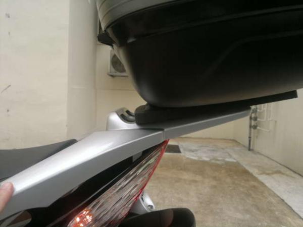

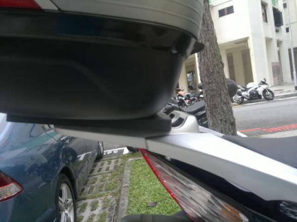

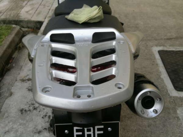

i got another issue of my current givi maxia E52 box.
i bought tat silver thick thick rack from yamaha cost me $600 but my maxia cannot fit in. my maxia catchment is 2 hole at the back ready to insert tat rack but tat rack came with 2 hole also left and rite.Therefore cannot insert .
yamaha mechanic told me i need to buy a base mount onto the $600 rack den can work. do u all guy encounter this b4 ?
Hi Anric, I also just recently got my Dec 09 TMax last week on the 23rd Sept, mine the matt blue colour, dunno if it is the same one mentioned earlier by someone here. Anyway, the good thing was that my TMax came with the thick silver bracket dat you mentioned earlier, didn't noe it was dat exp.
What you need to do is to get the base for the Givi E52 box which is different from ur default base on ur rack. Some bike shops may have used ones but new ones might cost up to abt $120 I think. (The one originally on the rack is good only for smaller boxes.) Then ur mechanic will need to position ur E52 box on ur rack and drill the base into the rack, 2 points is sufficient but I got him to drill 4 holes for me, kiasu bec I always carry heavy stuff. Dat should solve ur problem.

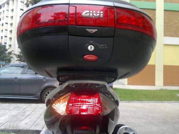

Hi trublue,
brother trublue can u take picture to show me how it look like? or if u dont noe how to upload to pc u can mms me my hp at 97402481. I heart pain when come to drilling, what i did is to go to mah bike shop ( Givi agent is there look for elyn) . she find for me the most possible base tat able to mount onto the thick $600 silver rack and den use bracket to fasten it. result is not so good cos push too far back in order to fasten. i will show u picture later to show u more clearly.
