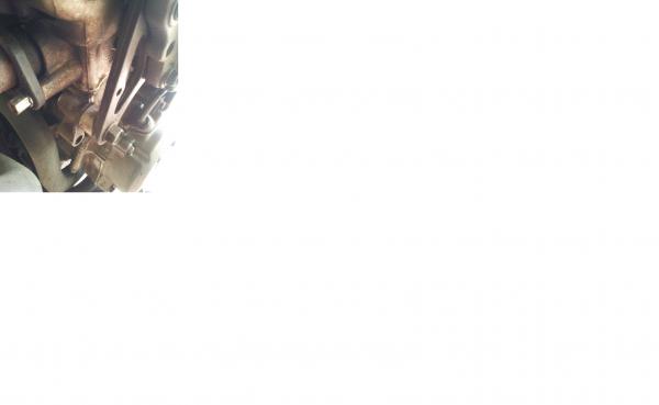

Just wanna share the photo...
Actually is the bottom block gasket near the exhaust header.
What kind of repair should I do ? Just change only the bottom gasket will do ? Anything else to check and replace ?
Thanks for any advice.

Thats the head gasket...top overhaul ah like dat haha...mite as well grind valve..

How much cash to prepare like this...? If only change gasket. I called up mechanic he quoted me around $200 to $300 for gasket replacement, checking valve and labour. Does this correct ?
BTW if grind the valve will reduce the tappet sound, right (knocking sound) ?
Yup cost arnd there
Nope have to check valve clearances and change shims...
