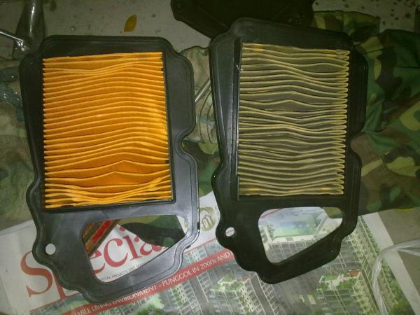

How to clean air filter? And in the pic i attached, left one is a new one and right one is the old one. Time to change it?
use air pressure to blow it/clean it will do.. thats what ah chong taught me..
lao jiaos, do correct me if im wrong.
to my best knowledge, TA200's air filter is meant to buy, dirty liao = throw away and get a new one (it's not very expensive either for a new air filter)
unlike TA150's air filter which is different, it can be cleaned, recharge and reuse again.
TA200's filter is paper based and totally bone-dry, while TA150's filter is sponge based. there is oil injected into the sponge, when you touch it or squeeze it, you will see oil on your fingers.
if im not wrong, ta200 can purhase those washable filter also.. But very expensive.. Not worth it.. i rather go LAB to buy a use and throw filter.. $10 only
