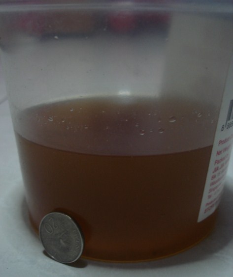

Ok. So i have bled and changed my rear brake fluid. Overall, it was a simple job. I used the method suggested in the Hands On section; i.e, filling the collection container with some fresh fluid (supposedly to create a 'one-way flow).
What delayed me was getting the right spanner size (size 8) and buying a tube which was too small to fit the nipple.
Some problems:
1) Somehow, those tiny air bubbles kept dlowing upwards from the nipple into the tube. So i wasnt sure whether all the bubbles were gone. Are the air bubbles supposed to flow INTO the collection container??
This seems quite illogical, since the container is 'below'.. as we know, air bubbles will always float upwards.
2) When I tightened the nut, a few big bubbles popped up from the nipple. I thought all the big bubbles were gone already!!
Tomorrow, I will bleed my front brakes. I need advice on whether is it correct to bleed one line first, then the other. Or must I bleed both at the same time?
And finally, here's the beautiful picture of the old fluid..
