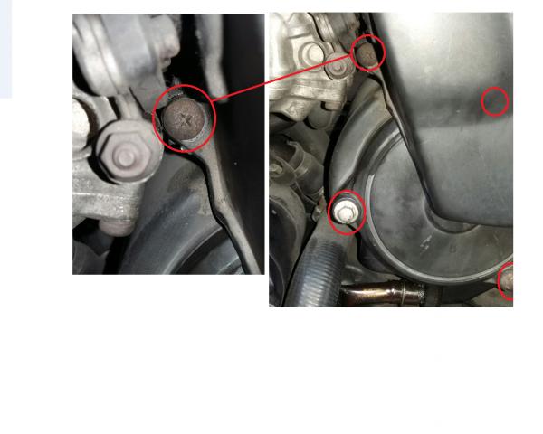

I have no idea how to open the air filter cover after unscrewing the 2 8mm screws. The carb dust cover seems to be in the way. Used to DIY a long time ago but cannot not seem to remember how to do it now...haizz.

There are 2 size 8mm bolt..u only remove 2. The 3rd one is covered up by the housing for the back carbs cover. Use a semi long Philip screw driver and remove the Philip screw holding that cover..right hand side of it..a bit in out of sight to access the 3rd airfilter 8mm bolt.
Thanks for the info Ah Pek. Yes,changed the filter over the weekend. Appreciate it.
Just to show the screws info graphically. The 3rd 8mm screw is being hidden by the carb cover.
