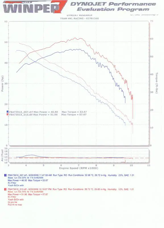

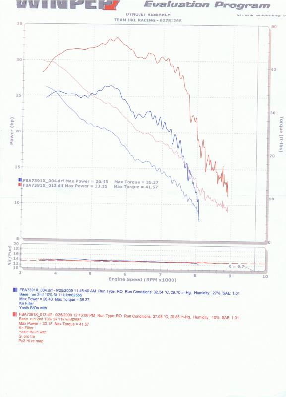

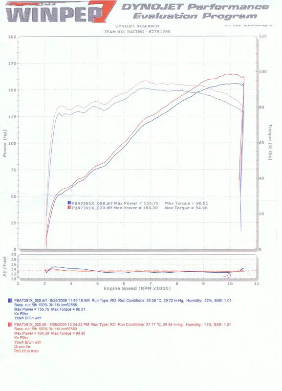

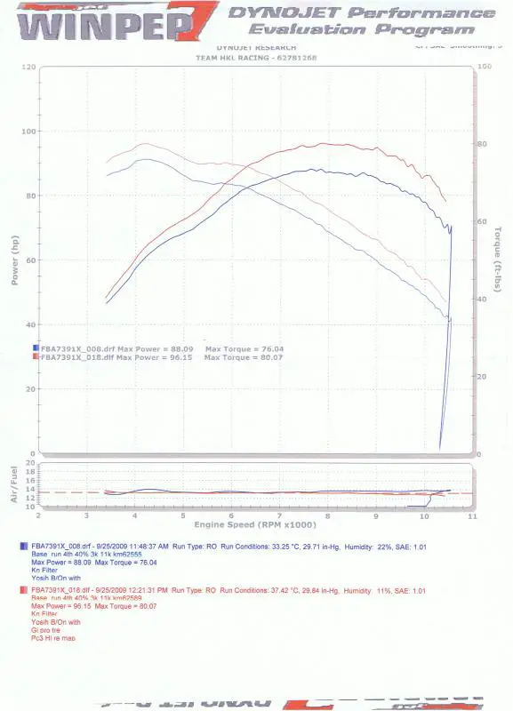

Dyno run i did a few days back.
At 10%,20%,40% & 100%.

the power output looks rather stock-ish...

bro... it look stock... :goodluck:

anyways, the problem is the exhaust now is stock and seems like the cams are not there... even with the HC gasket.. it's still breathing like stock... so stock HP is quite expected...
will there be much difference in HP if the bike is running as the above but with high cam?
properly tuned... you shld be looking ard the range of 170s... but the stock exhaust is really quite a killer for hp...
thats may be the reason plus he did not just drop in the cam he chged the degree. with the stock header constricting everything. have yoshi cam machaim like stock cams :cry:

thanks for the info, bro. but seriously so much diff.....stock vs HC.....?? :giddy:
anyway, with the current owner prefer legal, plus new 'discovery' after the dynorun, guess nothing much can be done :sweat:
Such a waste.....
That bike should be over the 200 mark if the project completed.....
