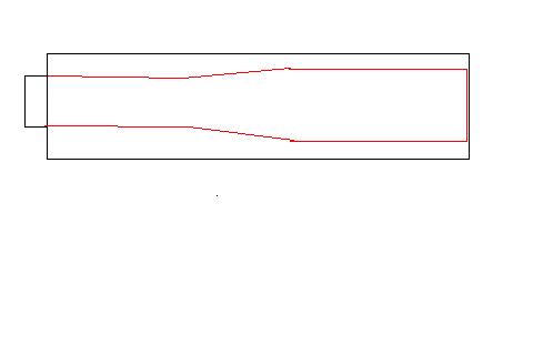

For Yoshimura street legal on RVF, there's no baffle..
The silencer core in the endcan is tapered so that the sound is softer, see attached..
I cant remembered if it's from big to small or small to big diameter..
For modding, it's the same as 2 strokers..
the core will have holes, drilling the holes bigger will achieve a deeper tone..
drilling extra small holes will gain a higher pitch exhaust..
any modification will deem the street legal exhaust illegal..
