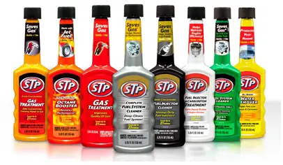

Perhaps you can try mixing some injector cleaner with ur fuel to see whether it helps to regain ur good fc?
As it helps to eliminate those built up carbons in ur engine and injector which enables your bike to run smoother and better fuel efficient.
Stp injector cleaner is always my prefered choice. "The blk bottle". There are some more popular brands like Liquid Moly, green oil eg.
Stp injector cleaners can be easily found in ntuc, giant, petrol stations and more.

thanks... but I just did that like 2 months ago...
Also, another symptom I'm feeling is a loss of power... my PCX can do 120km/h but these few weeks suddenly drop to 105...
I'm thinking...
1) clean my air filter as my mushroom head a little bit dirty already...
2) open up the transmission and check belt for worn belt (highly unlikely as I've done only 6000km on this belt), check clutch (could be an issue 'cos it's not stock) or check rollers (I don't know the lifespan for Dr Pulley sliding rollers but i've done 6000km on these too)...
