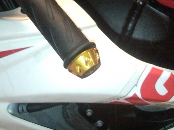

New Motovation Heavy Balancers with Barend Sliders
http://i450.photobucket.com/albums/qq228/uniquemotor/honda_big.gif
Price: $65 with installation ($75 for Fazer 1000)
Available for most bikes.
These NEW designed bar-end balancers are designed to be heavier than stock to cancel out the high frequency 2nd and 3rd order harmonic vibrations that cause discomfort and fatigue while riding (yes, they really work!). Comes with replaceable bar-end sliders, Machined from high grade stainless steel, these bar-ends weigh about 330 grams a piece.
Take the MOTOVATION test! Ride 50 miles with stock bar-ends and then replace them with ours and go for another 50 mile ride and we'll take them back* if you do not feel a definite improvement in your riding experience! If you ride longer distances you have to have these as they'll eliminate that 'buzz' you feel in your hands after a long ride.
Just installed this Motovation Heavy Balancers with Barend Sliders last week n its great...
Vibration really reduced alot n can really feel the difference :angel:

is this for handle bar or where arh ? pai seh abit noob on where this is place on..
since its heavier, does it affect heavily on mileage ? dun think so right since its not that heavy compare to human size..
yup its for the handle bars, at the end where the original ones is black in colour, the 2 metal round things.
Nope it doesnt affect on mileage. What it does is it reduces vibrations on straight roads by alot so that your hands dont go numb and u are more comfortable.
