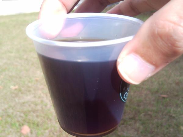

I had to top up my front reservoir once and the fluid looked dirty grey. The light wasn't too good so couldn't be sure how bad it was but that convinced me I better change all the brake fluid.

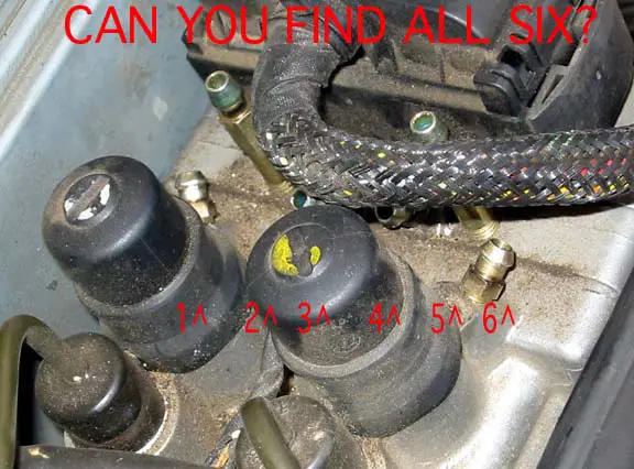

The rider from that pic did a careful bleeding at the calipers and thought it was all well. For some reasons, he went ahead with the ABS module and found this! How shocking it is! I would certainly want to bleed ALL of them for a peace of mind. That might also be the reason why ABS on some bikes failed which will cost a bomb.

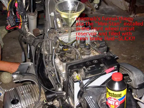

Finally replaced the brake fluid last weekend. To prevent any air being trapped, I removed the fuel tank and bled the fluid from the two nipples at the top of the ABS module (just like the pic at the top of this page). Then I bled the fluid from the three brake calipers.

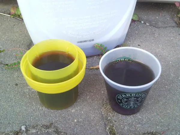

You can see the color of the old fluid. This has been diluted with some clean fluid in the process of bleeding, so the old fluid may be even darker in color.

No, mine is the 1100. I read only the 1150 models comes with servo assistance. Look at your photo at the top. That's the whole ABS module on my bike. Just 2 nipples pointing up and no opening for pouring in new brake fluid. All fluid has to go in through the front & rear reservoirs.
It is much less complicated than the 1150 ABS with servo assist, with 6 nipples to bleed and 2 openings for pouring in brake fluid. I am glad mine doesn't come with these. :cheeky:
