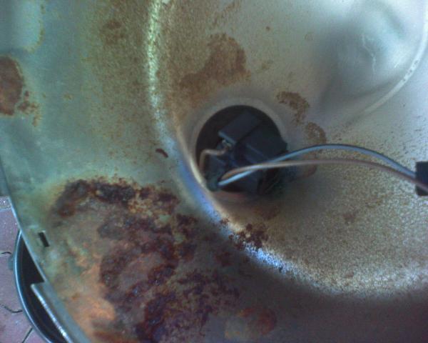

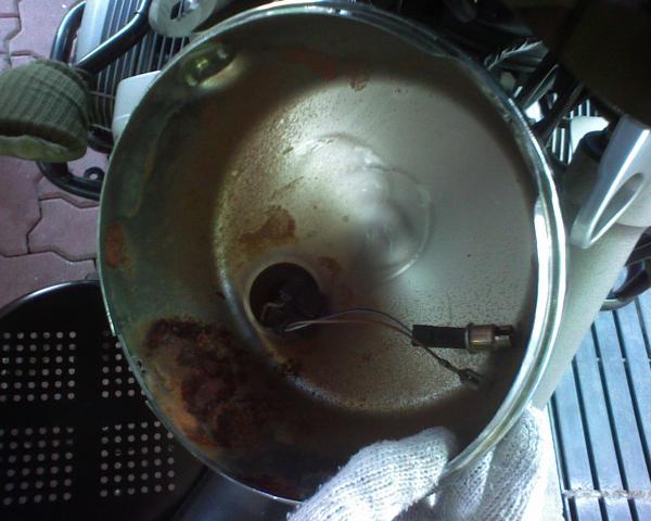

I dismantled the headlight to do some cleaning and look what I found. I expected to find some rust but not to this extent. The outside is still beautifully chromed but the inside is covered with rust. I used lots Autosol to remove the rust but the black patches remain.
My first bike made in Taiwan also had this problem but I thought BMW would use better material.
Also, I am unable to remove the glass to clean the reflector. Anyone knows if this can be done?
Hiya, Puff,
Sand down the rust with 800 grit. Use anti-rust to coat the insides of the headlight shell before re-install. I also used one of those rust conversion products too.
Pre-treatment
http://i49.photobucket.com/albums/f254/bikermeow/Mystic/P1030314.jpg
Post-treatment
http://i49.photobucket.com/albums/f254/bikermeow/Mystic/P1030317.jpg
The glass can be removed; you need to undo the wire clips that surrounds the back. Use glass cleaner to clear away the fogging that builds up underneath the glass. Do it at your own risk, don't break anything.

Are you referring to those liquid compounds that harden the rust to a black solid? I have the Turtle Wax Rust Master which I use on any rust I find. But it does leave a stain if I am not careful.
Thanks for the tip. Will try to figure out how to remove and clean the lens. Don't worry. If I break mine, I will go around and try to "kapo" other Roadster's headlight. ;)
