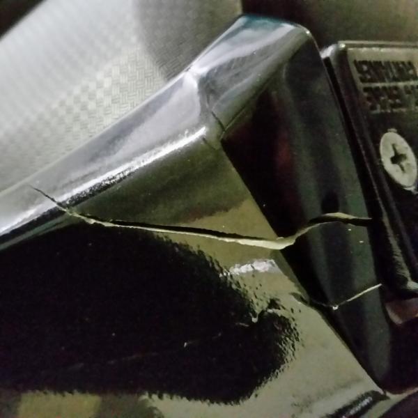

My handlebar cover has a split near the left brake reservoir. I think soon it will break off. Anyone experience this? How did you fixed it or did you purchase a new cover? Other than Mah, where else can we get it? Any possibility of finding it at scrap yard? Mine is 2013 model.
How's the split ? Can superglue back ?
Pic uploaded.
It's strange because I had cleaned my scooter a week ago and didn't see this crack.
[ATTACH=CONFIG]312421[/ATTACH]
Pic uploaded.
There are 2 cracks/splits. I wonder whether it's due to vibration as the edge seems to be touching the brake oil reservoir.
Bought a new one from Mah without installation for $25.
Took a matt grey one instead of shiny black (my bike color) as I find the shiny black throws the afternoon sunlight to the eyes. It's discomforting.
Have not fit it yet as Meng Tong/Sporting Motors is away.
