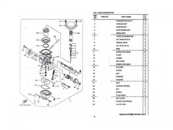

e 2 carb setting screws can only set e air being lean n e other for engine idle frens. dis is basic carb design. pilot jet installed inside e carb body determines e amt of petrol for combustion. by changing to aft market air filter like K&N it allows only more free flow air for combustion. carb bikes normally needs servicing periodically. jus like yamaha's RXZ. digital stuffs problem like meter shud go back to HL for repair or replacement. dun worry guys.... e bike's still on warranty go hantam HL for consumer rights. It's quite similar Comparing our bike to Phantom's setup jus dat FZ16 is to my opinion better. My fc was 50km/l during first 500km wen i was doin 4-5rpm ave 70km/hr. but e next 500km it has become less as on e highway i was cruising 80km/hr at abt 6rpm. still hav't chg to my KNN yet probably tmrw as im on my off day. chill la.....Enjoy :)
oh n is better to maintain stock sparkies as fuel cork type bikes like ours will need throttle cracking during engine start or cranking. cold type sparkies will on personal opinion give more problem. Steady bon pipi..... la
Bro, you could be the defacto FZ16 technical manager. For the carb lean/rich screw, which one is it according to your diagram?
Thanks in advance.
