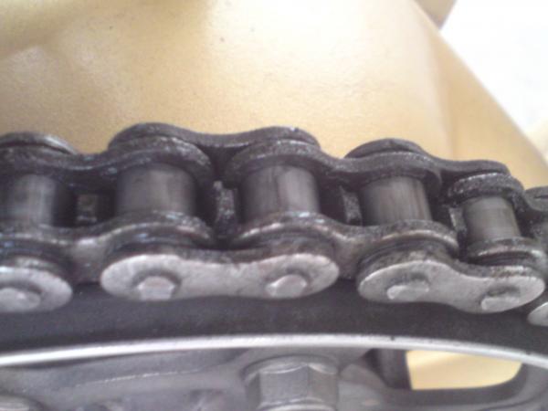

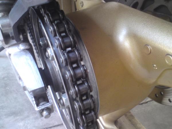

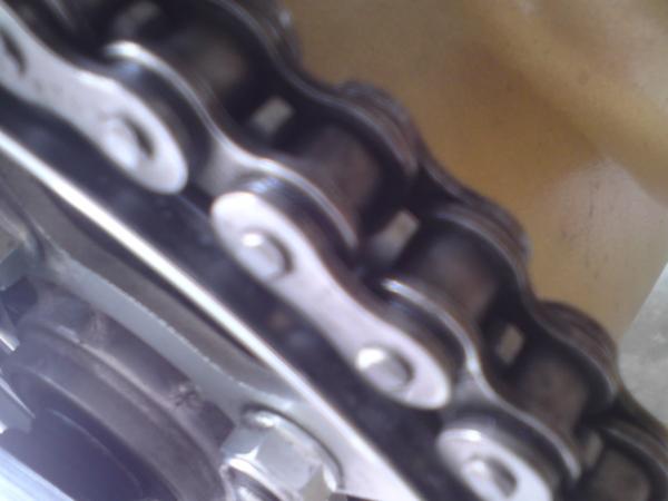

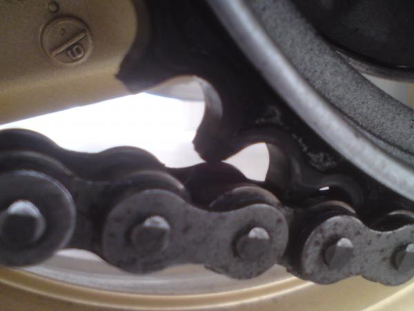

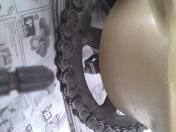

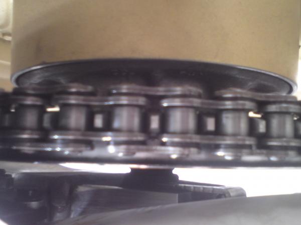

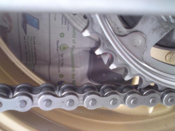

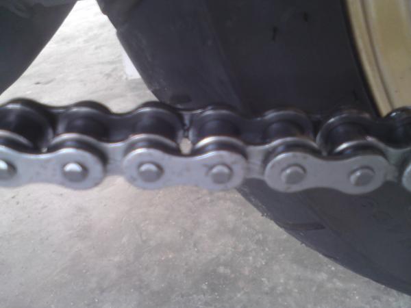

Just to share with all how the chain lube looks after applying onto the chain.
*Pls take note the pics were taken before cleaning of chain and spocket [look at the 'grinding paste' on the inner plates of the chain and spocket] and after applying the chain lube after cleaning.
No riding was done after applying the chain lube as I was too tired after spending nearly 2 hrs to remove the 'grinding paste' caused by the previous chain lube i used.:cheeky:
I will continue to update this thread with pics of the chain lube on the chain and spocket after putting on some milage.

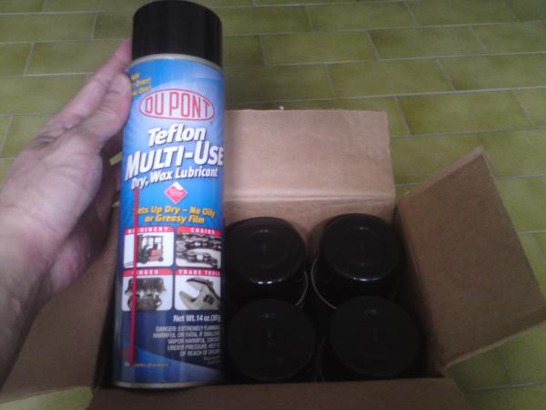

So far i cant find it locally. But i manage to find a supplier who helped me bought in 6 cans. I kept one for my own use and had sold off the balance 5 cans in the garage sales. :cheeky:

Ya. It does not give the wet look like other oil based chain lube. If you read the instruction on the can carefully, it say goes in wet and dries out. If you have clean ur chain like wat you did after range during ur NS life, spray the lube onto your chain and let it dry completely. After that run ur figner across one of the chain plate and u feel the lube gives a waxy feeling like rubbing of candle on paper that type of waxy feel.
If you didnt do a complete chain clean like me [i didnt clean the front spocket], high chance u will see the 'grinding paste' beng forced out by chain lube. Look carefully and you will notcie a thin layer of the grind paste on my rear pocket teeth. :cheeky: I going to remove them during my next chain maintaince. Look at my rim and inner sides of my spocket and notice that its near zero fling of the chain lube. Tats amazing. :thumb:
