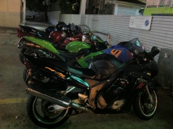

will be nice to have another bb on the rd..
btw early mon morning jb petrol topup chanced upon 2 bbs..red fbf bb & the black al5* bb with an injured fairing ;
The outer most BB reg plate is AL55 rite?
[ATTACH=CONFIG]253156[/ATTACH]
oh yes..the orange one. :-)
Yupz saw ur bike at Yishun carpark yesterday. But when I came down back bout 1 1/2 hr later, u oredi go off liao...
