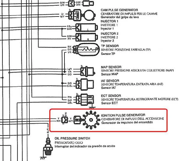

Connection/Circuitry
Seems to be that on called "Ignition Pulse Generator" (at centre right side of diagram)
See post #40 FJS400 Electrical Wiring Diagram
http://www.singaporebikes.com/forums/attachment.php?attachmentid=269211&d=1359518523
E.g. of how pulser coil is connected (based on Honda CBR250)
http://www.wiringdiagrams21.com/wp-content/uploads/2009/04/honda-cbr250r-ignition-schematic-diagram.png

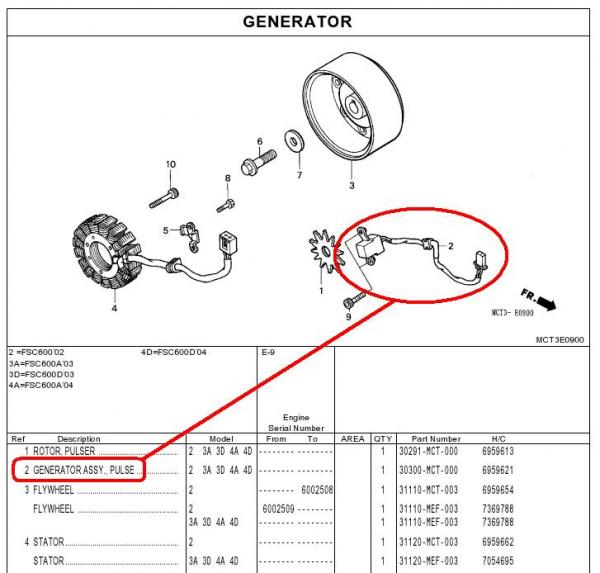

Replacing the SW's Pulser Coil
The pulser coil is located under the right side engine cover (same enclosure as where the magnetic coil is).
To replace it, we will have to apply the similar procedures as when changing magnetic coil:
* drain the engine oil
* open the engine right side cover
* replace the coil
* seal back the engine right side cover
* replace with new/recycled engine oil

So, I make that "get o" wire for programming ECU, and follow the video tutorial, but with no success....
I found IPG ( ignition pulse generator ) red connector behind right supporting foot (metal part with two screws), and I connect my "get o" wire there, with 1W 100ohm carbon film resistor in middle of + wire, the one witch goes on yellow wire, with original key in side lock on position OFF, and connect clamps on battery, first -, than + !!
Than I put key in ON position, and I have HISS light stay ON firmly as should be, but also I have F1 light ON too, I do not know is that should be, and further I follow instruction, I disconnect + clamp from battery, in many variants, from 3 sec to 30 sec, but with no success to get that mode what I need, indicate with four repeatedly blinking HISS light for four time, all the time it stays ON firmly :-( ....
So, as you can see on you tube, below that video, comments people who manage that, it's possible, on different bikes, so I believe that it's possible also on SW, but I miss something...
Maybe it's about timing, or resistor, or maybe some switch about, maybe some relay protection access to ECU, or I must connect it directly on ECU....that is reason why I need help from you guys, information is there, just need to get it...please share it....
I know that licensed services have that info, and some good professionals or just hobbyist in locksmith profession, but question is will they share that info with us....
Key is I think in protocol-->procedure ...
Thanks all of you in front, I think this will help many of us if we solve this out....
