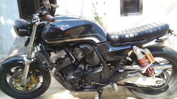

Well it's almost finished, couple of small things to do this week and its off for an inspection at the LTA.
it started life as a very tired 1998 Super4, i picked it up cheap before going to be scrapped. with a great deal of help from a buddy down the road, we set to work on it!
Complete strip down
Powedercoated frame
Powdercoated wheels
removed anything that was not needed - no excess weight
Clip on bars
rebuilt forks
chopped front mudguard (fitted after pics)
new braided brake lines
new pads
Trailtech vapour dash
Cafe racer aluminium seat
Seat and tank chromed
Chrome Cafe style mirrors
Stainless steel exhaust (not in these pics - Stock installed for LTA)
All new Stainless steel bolts
re-routing of wiring to under the seat
Ballistic battery under seat
modified rear sets
Modified Exhaust brackets (fitted after pics)
removed air box and fitted pod filters
re-built carbs (still need rejetting after final exhaust installed)
All hoses replaced
new water pump
replaced faulting & burnt out wiring
New Pirelli's
new bushes and bearings
going to head up to LTA this week, wish me luck! :-)
